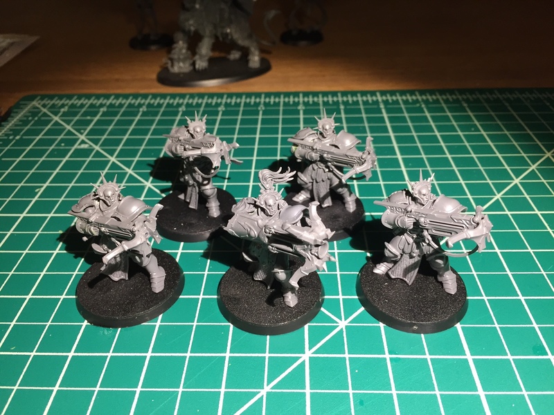

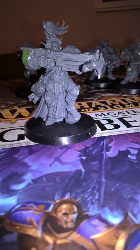

Hyperkinako Posted January 10, 2017 Author Share Posted January 10, 2017 Ok, so finally got around to finishing my Judicators. As expected the biggest issue was with the right arms, from the spare parts I had after building the other kits I found the spare Prosecutor arms to be closest to the position needed to fit with the back of the crossbow. However there was only a few of these available so the remaining I had to pick from liberator arms cut at the glove. I used a small ball of green stuff at the shoulder and wrist joints to allow as much re-positioning as possible and to fill the gaps. Some required very little work but a couple had big spaces to fill which I couldn't quite get right. I'm happy enough with the results and think they will be fine once painted, but a little disappointed at the shape of some of the models, slightly elongated arms and odd poses. Think it would maybe have been better to build the base set with crossbows and then cut the bows away from the arrows and just have the archers holding bows not firing them. Link to comment Share on other sites More sharing options...
chord Posted January 10, 2017 Share Posted January 10, 2017 Looks good thanks for the photos. I actually like that each one looks slightly different. Seems more dynamic. This might be out of my skill set, I've never worked with greenstuff before. Link to comment Share on other sites More sharing options...
Hyperkinako Posted January 10, 2017 Author Share Posted January 10, 2017 3 minutes ago, chord said: Looks good thanks for the photos. I actually like that each one looks slightly different. Seems more dynamic. This might be out of my skill set, I've never worked with greenstuff before. This is my first attempt with greenstuff too, other than sticking magnets to bases. Its actually simple for something like this, if anything I used too much and needed to cut some off once dry. This was also needed as it got a little messy as I didn't use water to handle it and don't have tools so just used my fingers and a knife. If its just the greenstuff putting you off I would not worry. Link to comment Share on other sites More sharing options...
chord Posted January 10, 2017 Share Posted January 10, 2017 43 minutes ago, Hyperkinako said: This is my first attempt with greenstuff too, other than sticking magnets to bases. Its actually simple for something like this, if anything I used too much and needed to cut some off once dry. This was also needed as it got a little messy as I didn't use water to handle it and don't have tools so just used my fingers and a knife. If its just the greenstuff putting you off I would not worry. Glad to hear it, I think I'll put this on my project schedule then! Thanks! Link to comment Share on other sites More sharing options...
Hyperkinako Posted January 11, 2017 Author Share Posted January 11, 2017 Damn..... Just realized I have equipped the prime with the Thunderbolt Crossbow but he doesn't need to roll to hit with this weapon so looses his bonus..... do I try prying the head and shoulder off now ????? gggrrrrrr knew I should have super glued them first Link to comment Share on other sites More sharing options...
