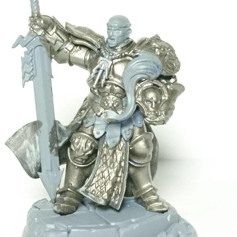

Layer and highlight with ironbreaker, runefang and finally stormhost as an extreme highlight. Nothing odd yet, this is just the standard method I use for silver/steel. From here you could just wash with badab black or earthshade, or maybe blue if you are feeling adventurus and you'll have yourself some basic steel armour. However...IMG_20180205_221133_690.jpg.e90f3b79db989ff2d35a98a4033e8f70.jpg
...we want gold. This is a simple allover wash with Cassandora yellow mixed with a bit of eartshade. The metallic shine is still there, but the hue is changed completely. If you want a less deep and saturated colour, mix the wash with with some lahmian medium. What's great about it (apart from not having to have a shitload of different expensive metallic paints that dry out all the time) is that you get an instant shade to the gold, with shadows that are really just a deeper variant of the base colour. And the pre-highlighting means you already have that  step sorted too. IMG_20180205_221133_687.jpg.d742bb3fdf29b8b06c232a7f8c9f6a90.jpgThe rest is gravy. Some extra stormhost highlights, a little diluted eathshade in the recesses and a final light wash of gloss black to get a bit of shine.

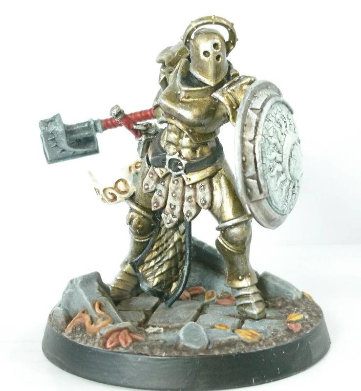

The three finished shadespire minis bellow all use slightly different recipes with different mixes and intensities. I'll probably keep perfecting it for a while yet.IMG_20180313_233311_469.jpg.89d27af33a1a8dbde39c47590063d4ec.jpgIMG_20180224_140152_460.jpg.a1d93b5e12cf9a0148833771f174e819.jpg
